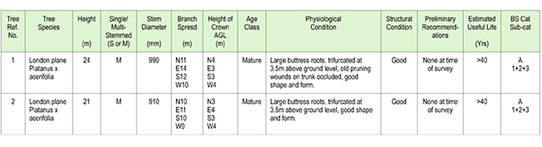

The BS recommends an arboricultural assessment be completed before any site plans are drawn up. The Arboricultural Survey will comprise a standard data set entered for each tree, similar to the table below.

Also, trees in categories A, B, and C will be assigned at least one sub-category relating to distinct values:
1.  Arboricultural values;
2.  Landscape values;
3.  Cultural values, including conservation.
A tree may be considered worthy of one, two or all three of these sub-categories.
